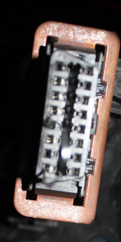

Now find your data port which is by your right knee under the dash. What you will do is insert the paper clip into slot 1 and 4.
Now that you have these you are ready to begin. This is a sequence/timed event and you only have so many seconds to finish the next task. So first start by putting the key in the ignition, but do not turn it.
Within 10 seconds, insert the jumper into slot 1 and 4 in the data port.

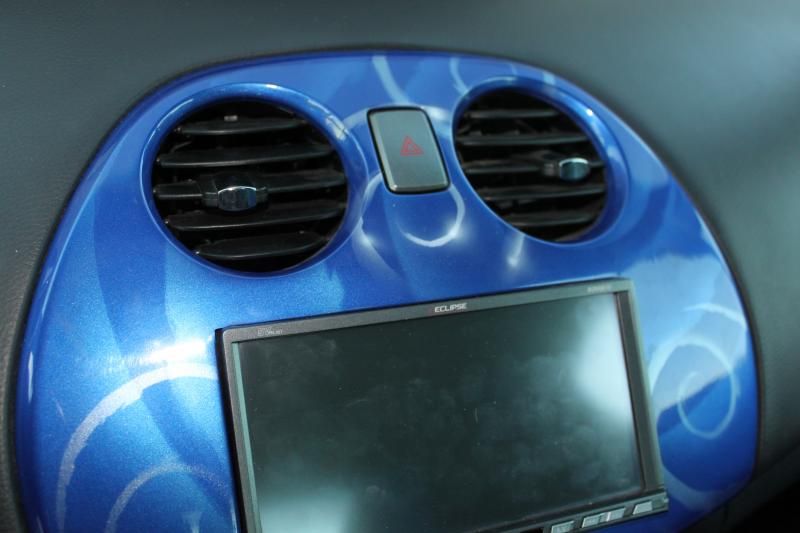

Now push the hazard button 6 times.
Once you push it 6 times the doors will lock and unlock letting you know the car is now within program mode. Now push the lock button on your remote three times. Again the car will lock and unlock. Do this for all keys you want to have access to your car.

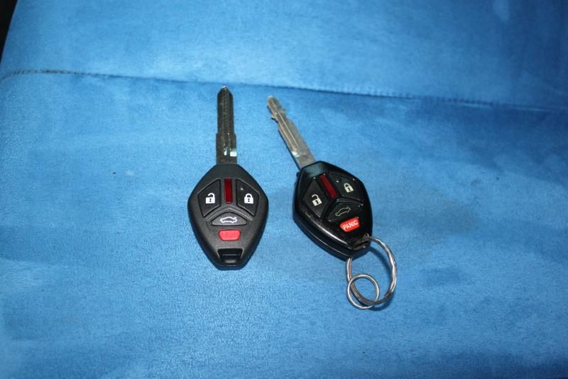

btw, your new key, has the wrong blade! ( key to the left, not cut yet...)
the key you got on ebay is for a 08-2012....
they all say theyll work but there wrong....it will not fit in your ignition.
Your oem key, to the right, thats cut already, is for a 06-07. ( your car )
your keys groove is on the right...
the ebay key, to the left in the pic, is for a 08-2012
the blades groove is to the left, and it has 'stops" or shoulders...
pm me if you want any help or clarification. : )

After I programmed the key I noticed that the blades were reversed and you were right the ebay ad said it would fit. Lesson learned. But at least I do have a backup to unlock the car in case we lock the original one in the car and I will have to find a shell key and move the chip over to it.
