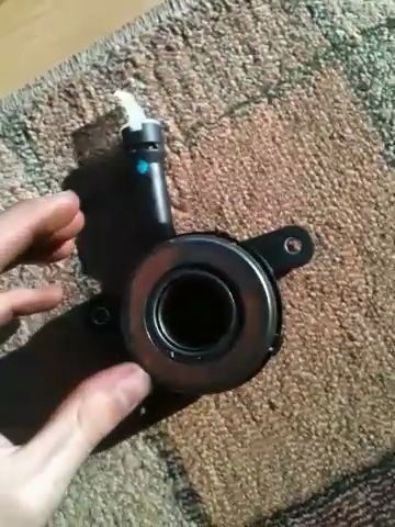

Here ya go I made a video for ya
http://i897.photobucket.com/albums/a...e/482706ac.mp4
THE FIRST EVER 4G RUNNING STG 3 SUPERCHARGER
TEAM BIG SUPERCHARGEERS
dejectedangle is offline   Reply With Quote

The first noise....

As for the wining noise maybe try the fluid? I do it every 30k!!! And just next time u do the clutch do the bearing it's 150.00

the bearing and clutch should always be done together, besides the fact that when you pull the transmission off, the TOB will probably fall into pieces anyway, by the sounds of it...
