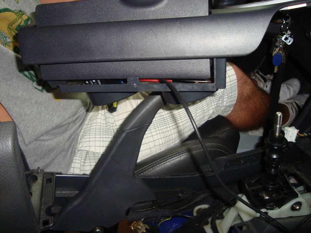

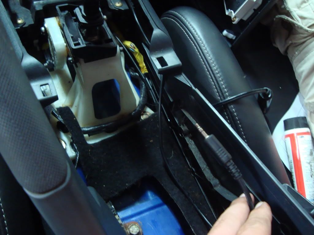

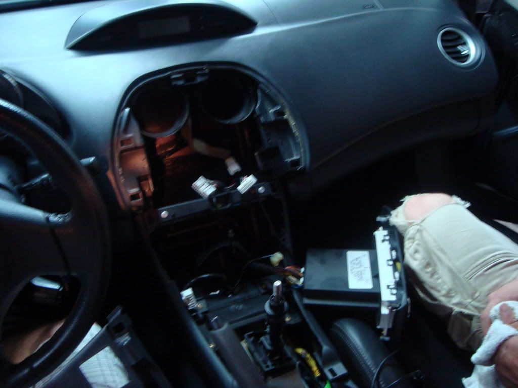

this is just a quick thread about how i installed my aux cable i bought at the dealership for bout 25 bucks.
first just pop off the faceplate, gently pull from the bottom an should come right off, dont forget to unplug the connector to the hazard button.

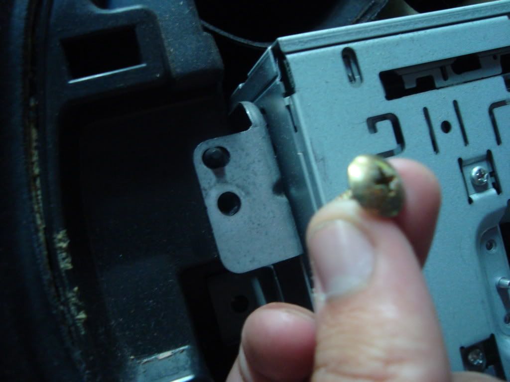

next unscrew the four screws holding in the stereo.

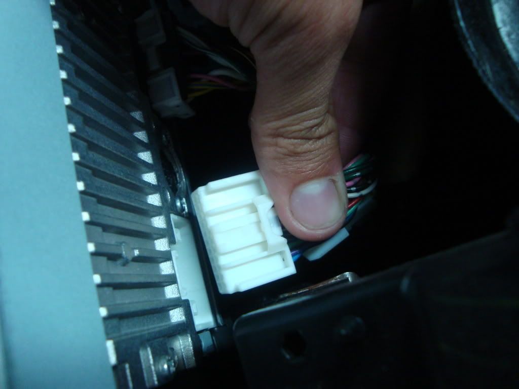

then unplug these connectors so the whole unit can come out.

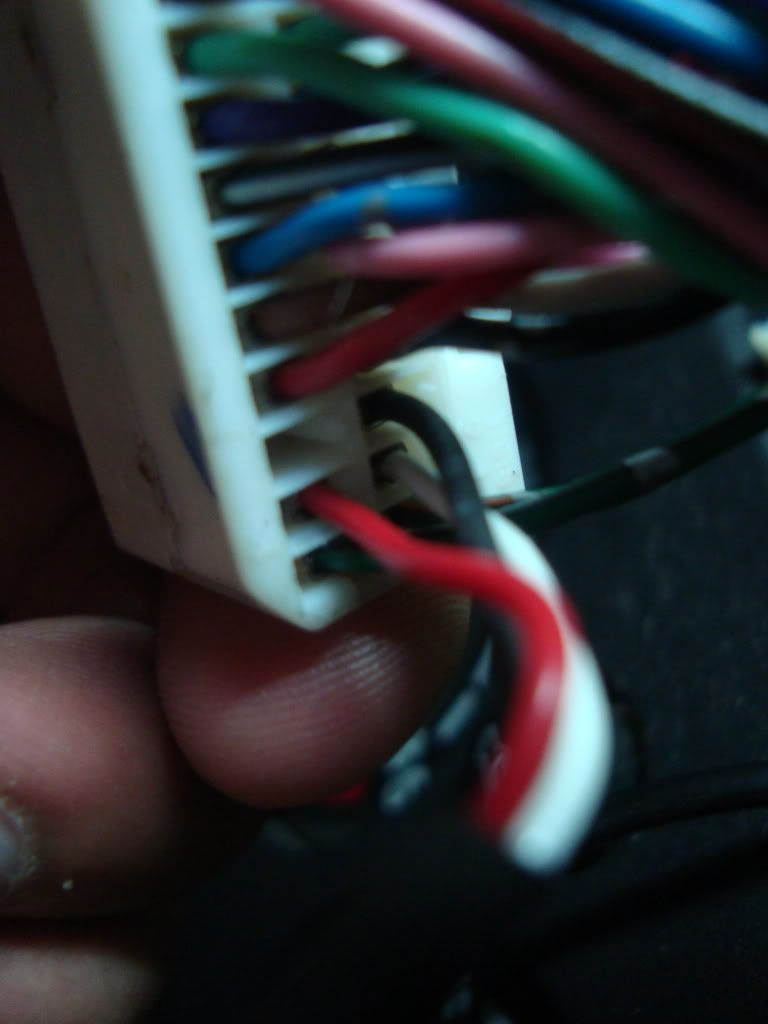

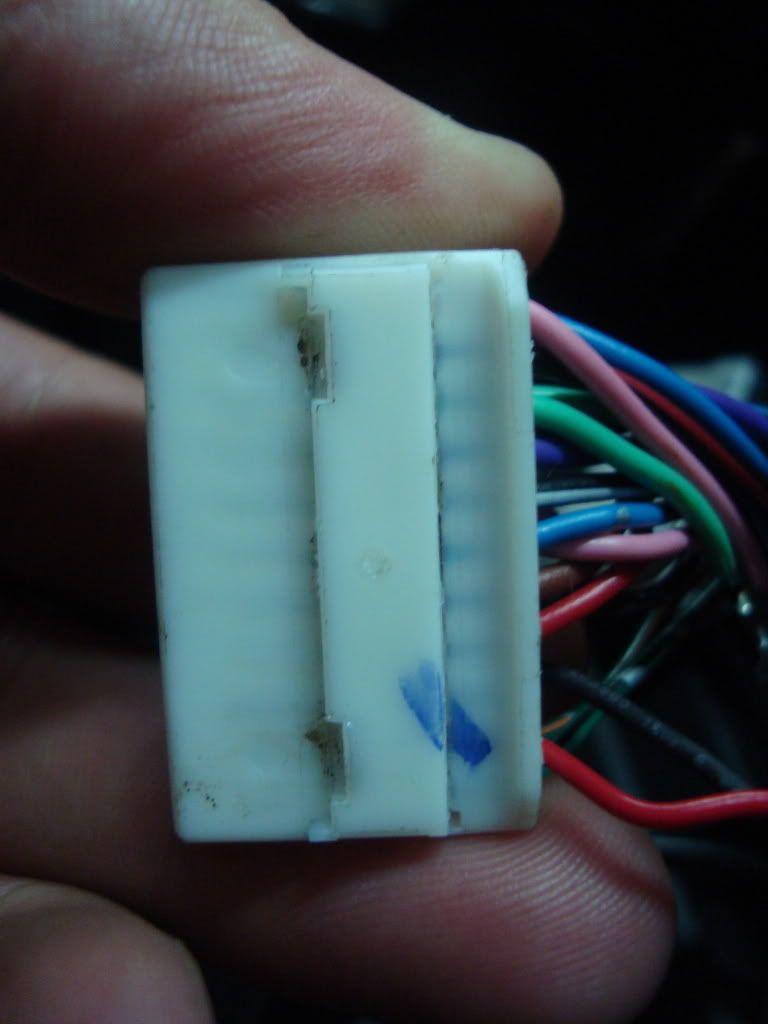

after that make sure to lift up the little retainer so that you can easily slide in the three pins.
the three pins go in just how you see in the picture, the red goes into the bottom right open slot , the white goes right above it and the black goes just to the left of that. so the only open spot is the third to last opening on the bottom.

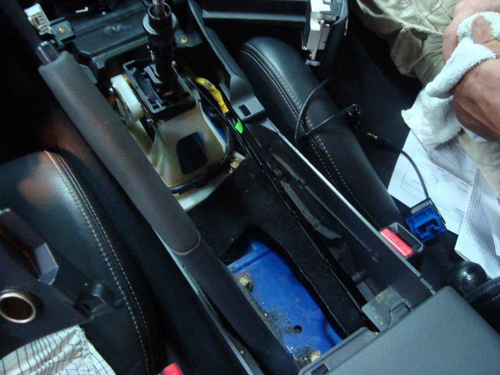

next i took off most of the middle section, everything easily pops off, just remember to unplug everying.
then i basically just ran the cord along the right side tucked away from everything.

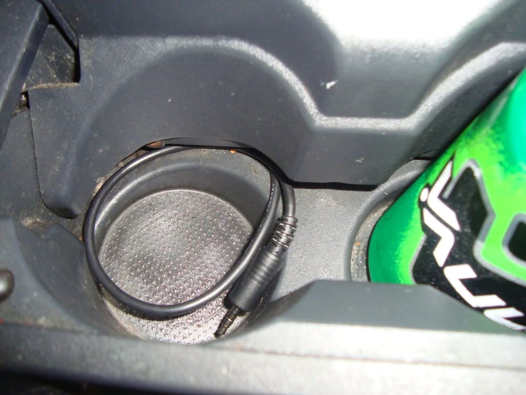

the cup holder is a perfect place to run the cord, just slide it thu and the top will still open and close like normal.

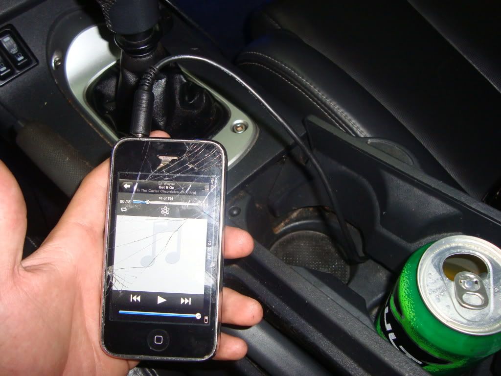

everything works perfect and sounds amazing! i reccomend this for everyone.

Ok here are the instructions I got from my dealer. They have been great to deal with so far.
And the part purchased
If anybody needs a more detailed pic I can send the full size pictures by E-mail.

i ran mine to the right onto the floor..under the glove box.. i got the other cable in my glovebox but idk what its for :\

I ran mine through the centre console and it comes out from the parking brake area. It looks clean and its easy to access.

Saaaweeeeeet. I've been wanting to do this. Our phone screens look alike too, haha. +1 buddy, I'm about to call my local stealership now.

haha yaa shit happens ! i iphone was free cause its all fucked up so i js use it as an ipod, and i think into the cup holder is still the best place to run it!
