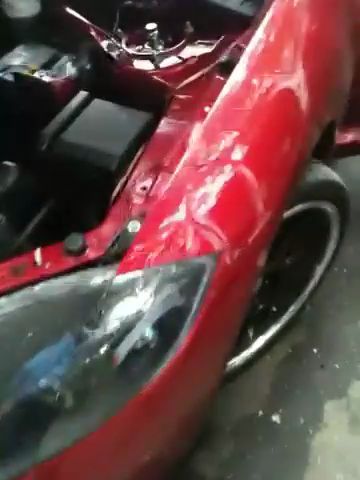

Well I've ha a couple members ask about a good way to cool the engine bay down and running the condenser fan wial the cars off is a great way for quick cooldown like if your at the track...
http://i897.photobucket.com/albums/a...e/f1efbcac.mp4
HERE IS THE WALK THROUGH^^^^^^^^ video
I used 12 gauge wire and 50 amp fuse and 50 amp switch anything smaller will overheat enjoy any questions ask it's pretty straight foward

Here's the blue and blk wires going to the fan.... Tap into the blk one not blue

Ok well my 30 amp fuse and switch blew today I saw the stock fuse is 50 so well if I told anyone 30 amp is good I lied sorry guys must be 50 amp the 12 gauge is still good though make sure it's true copper wire
